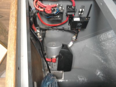

Same with mine - just finished taking the charge wires from the B2B up to the bow. Bow thruster uses the same battery. All serious heavy duty cables from battery to windlass and BT
However, not much use to the OP whose windlass runs off the domestic bank at the rear of the boat.
