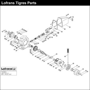

It appears from this diagram that pressing/tapping the threaded end of the shaft should release the inner cone. Obviously needs care not to damage the threads. Maybe put a nut on first? Perhaps safer to detach the motor before trying.
