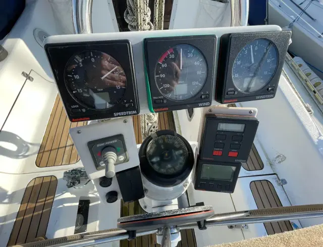

Good Evening All,
I have a new to me Parker sail boat and she needs some tlc.
The wind instruments are not working and this was noted on the survey. As the boat was transported, the mast is currently down. So this is a good opportunity to fix them.
The instruments are Autohelm (I think thats Raymarine?)
My plan is to test the continuity of the cables in the mast and I am thinking I should just replace the wind transducer with a new one. My question is, are transducers paired to certain brands? i.e do I need an Autohelm / Raymarine one?
I hope to replace the transducer and then get the mast put up and see if I need to change the instruments too.
I am also going to change the bulbs on the mast lights to LED (or replace the light unit completely, depending on condition).
Lastly, is there anything else I should do whilst the mast is down?

The wind transducer must be Raymarine to work with the Autohelm display. The instruments in your picture do not use NMEA 2000, they are Seatalk. They can be linked together and can be connected to a converter to integrate with whatever plotter etc you decide to go for.

Raymarine give all the test information for the ST50 masthead unit (likely installed with those instrument heads) here...
Raymarine Masthead Wind Transducer Test
Thank you, this is super helpful. I will do the tests.
