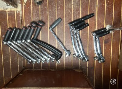

A related issue:
Seven Harkens, one Lewmar square drive, three Barients, two Arcos (who were Arco?).
The Lewmar will work in a Harken socket but only half the area of contact is present.
It’s a cuckoo in the nest.

I actually filed down the square on al old Lewmar item which should do the job. Annoying because the cockpit winches are the old size and the mast winches the new regular type. :confused:
