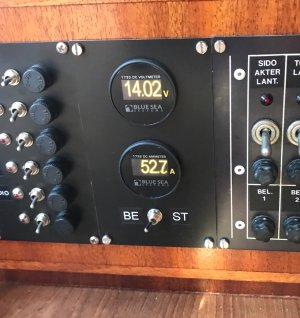

For comparison, below is over 50 A going into my well depleated AGM house bank of 270 Ah. 70 A alternator and the engine running at about 2 000 rpm. Battery voltage just before charging began was 12,27 V with all loads turned off, so probably a SOC of around 30 percent or so.
As can be seen from the low voltage reading, the charging is clearly in bulk phase.

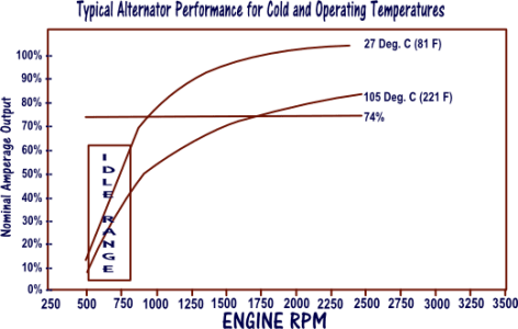

So many factors will limit the charge from an alternator in to LA batteries. To get a large charge in to batteries will usually require 14 .5 volts or so. Your alternator may not be able to maintain 14.5 volts at the high current you hope for. (alternator claimed rating)
Alternator output is determined by alternator RPM (engine speed and pulley ratios) and may be temperature limited. Then there is the wiring and the splitter which may limit current flow. I would not imagine your splitter will deliberately limit current flow but may provide some restriction. (all assuming it is a no volt drop splitter)
So your 30 amps actual delivery might be good. ol'will
