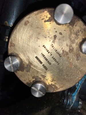

Is there anyway of telling which raw water pump i have on my Twin Hino WO6D ( 250hp 6 cylinder) engines?
I want to get impellers and change the antifreeze but would have liked to have the parts before draining and doing this.
The pump covers usually have the name and part number stamped but my covers are speed fit so no clue to the make or model of the pump.
Thanks in advance.

Contact Tides Marine with the part number of the cover. They will know which pump it fits.
Thats the problem there is no serial number on the cover only
" tides marine, speedseal, patent and design protected" but i will try them and see if any help. Thanks

That is a standard cover - just has thumb screws instead of normal screws. Not sure it is Tides Marine as they don't seem to make water pumps of that type. You could try their UK office in Poole shaft-seals.co.uk
