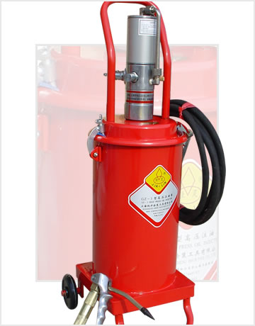

I use a large unit we used many years ago in the mining industry, this sits on a 20KG keg of grease and is one we used for lubricating underground mining machines.
It has two stage pumping, normal low (ish) pressure for normal greasing, and an internal, smaller piston for high pressure pumping which activates if the low pressure is not high enough. It has a 45' flexible hose and a variety of ends for various fittings, and is probably as old as i am.

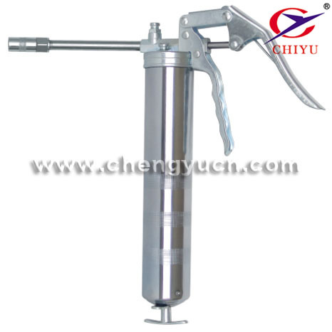

Leaving aside the "you shouldn't have bought that type" comments.
I have this style of grease gun
Whilst I can unscrew the barrel and put grease into it, it is very difficult to get it to pump anything but air. There are no instructions with it, any ideas on technique

I can see the bleed screw from here! put the grease in with a spatula shove it as hard as you can, replace the lever top, let go the rod/spring, release the bleed screw until tha air stops and grease appears.
