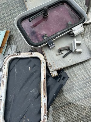

Which hatch type is this?
Strange and I would agree, it doesn't look like a rollstop, but it does seem to have the same sort of means of holding it up, namely teeth on the lid into which a bar locates. This, in turn, is spring-loaded by a rubber extrusion underneath it. That's the bit that ages and allows the lid to drop. SInce there are no spares, you can find rubber strips on eBay that can be trimmed to suit.
It looks like a Lewmar Superhatch
Lewmar Hatch Range Identification
The advise is not to dismantle the hinges!
Edit: Its not this type of hatch. The OP image the key shaped rubber has a flat base, the Superhatch does not have that flat base to the rubber.
Edit: But this Superhatch does have the key shaped rubber with a flat base. Hence, hence the OP's hatch appears to eb a Lewmar Superhatch.
