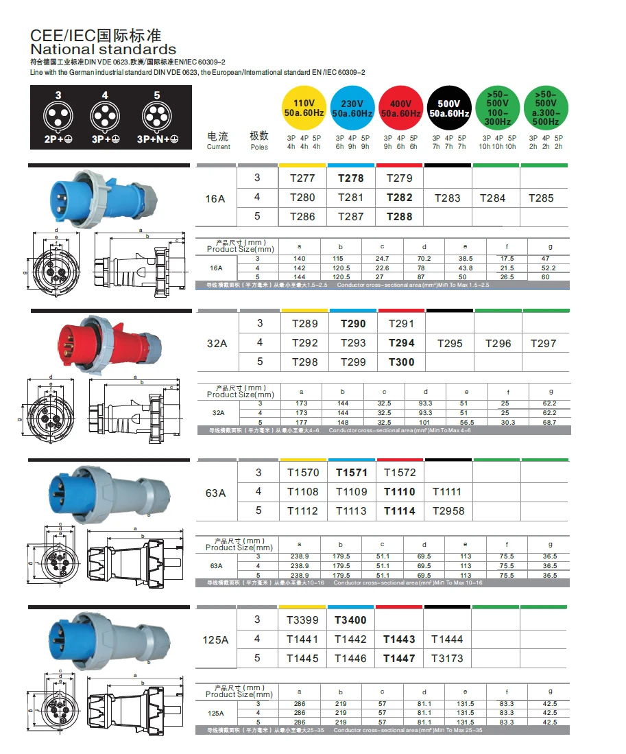

The physical size of 16A and 32A CEEFORM is different. They won't mate if different ratings
True, but he said Marinco, which is usually those nasty American twist-lock things with really small contact area and a tendency to catch fire. Not Ceeform.
