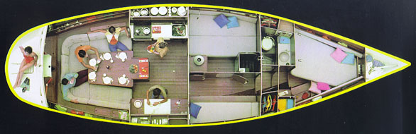

My problem with the amount of outlets I need is that the boat has an aft saloon, 1 X double and 1 X single cabin amidships and 1 X double up the pointy end making for long runs:
Anyone fitted a Webasto Thermo Top E water heater + radiators to a sailboat? If so what are your impressions?
