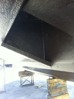

Tend to cruise near 30 knots .I maxed it last season at the end Sept and it reached 38 knots and 70 rpm over manufactures rated rpm @ WOT which tells me it’s correctly propped , motors are healthy and the AF regime works .
It’s not smooth .Never was when I acquired it back in 2014 .Thus because there’s no apparent drop in performance ( which Bouba is intimating if I I have understood his line of thrust ? ) I have nether bothered to strip it .
The difference might be it lifts up and out a lot above 24 knots reducing drag so any WL , the first few inches gets air not water .Wether Bouba s Semi D “ lifts “ enough, or doesn’t means perhaps at semi D or D a rough surface might be detrimental? But if he’s chugging along @ 8-12 knots on a single small engine I can’t see the cost benefit ratio , the € splashed out on a shell blast , re epoxy ( all blasting damages btw irrespective of media ….it just some are less invasive than others ) then fresh AF is gonna pay off in terms of fuel usage .
The science behind a smooth bottom is not that straightforward.Maybe in a yacht race down between 6-9 knots in light airs perhaps if you loose by 7 seconds you might regret not polishing the hull the day before .
But a planning boat not so sure .A semi D or D single engine low yearly hr then it’s waste of € stripping.

Not the smoothest surface ( underwater exhaust area )
Any real or perceived drop off in performance is unremarkable.

So think of the air bubbles / gasses interacting with that scabby surface on the pic i illustrated ^ .Air drawn i n from the strakes and the speed 26- 30 knots or so .If the air separates the hull from water then drag is reduced .A super smooth surface might not achieve the same sepertion levels as a micro dimpled . = your point / observation .
Also ( sorry folks for bring ing Itama in ) the underwater exhaust air ate the posterior sections at the stern .Engines are mid mounted so a lot of area distal is air ated .Adds up drag reducing .

Not wanting to dive down another rabbit hole folks remember the strakes or indeed steps on some hulls ….Some more pronounced then others Inc Bertram’s btw ....@ P speed ( not D or semi d Boubas boat ) air is introduced under the hull .A rougher source might create micro vortices .This will reduce the surface contact area of the denser draggy water when totted up .By way of example your lung alveola the micro structures that transfer oxygen into your blood ….if extended and spread out have the surface area of a tennis court .
