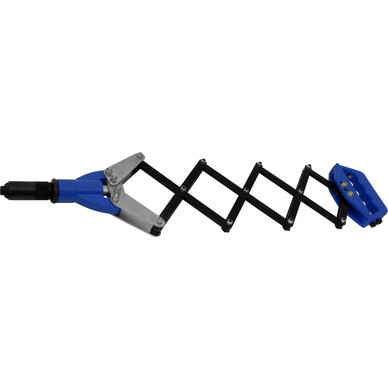

If I was looking for something better and more expensive to st big Monel rivets it would be the long handled two hand type.
This sort of thing

Having fitted home-made steps to the mast of my previous boat using monel rivets I would suggest that nothing less than a good lazy-tong type riveter is the way to go.
This sort of thing
That's the type of thing I finally pulled the trigger on as a decent power one is close to 1k, I don't do a huge amount with it, perhaps thirty or forty mixed between riv nuts and pops a month, I got the Sealey one.

This type of gun will set aluminium rivets up to 4.8mm
It wont set Monel rivets that size
For larger alumium rivets you will need the lazy tong type.
A decent ordinary lazy tong type or lever action type will set Monel rivets up to 4.8 mm but for larger sizes you will need a heavy duty lazy tong or a lever action type.

Monel rivets are very hard to set with a small hand gun.
A large scissors type gun will make life easier - but the £20 ones are rubbish. Look around engineering outlets for better quilty rivet guns ie - here.

I have a couple of rivet guns, one like that shown above by VicS which is perfectly ok for most jobs. I also have pair of cheap lazy tongs which I bought a few years ago to do a repair job on a spinnaker pole end. I bought too cheap; it worked but the jaw didn't eject the spent pin so I had to strip the chuck with each use. The one posted by bigwow looks nice.....
