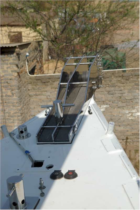

This is my twin bow roller setup
Th bollard has now been converted to a chain stoppers with a flap mounted on the horns of the bollard to act a a stopper in either direction up or down.
This shows it mounted with a bigger bollard aft and the mounting for the windlass in between next to the foot buttons.
Setup a launch
Thing of great beauty! :cool: Good few Kg of stainless there, must have cost a bit just for the materials!
Ah, excellent idea :) Stopper at the roller, worth starting the thread just for that, weld on couple of nuts to the cheekplates and fab something up as a flap :cool:
Will never be a as pretty as yours but no matter, first priority is V strong and works, pretty comes afterwards these days :)

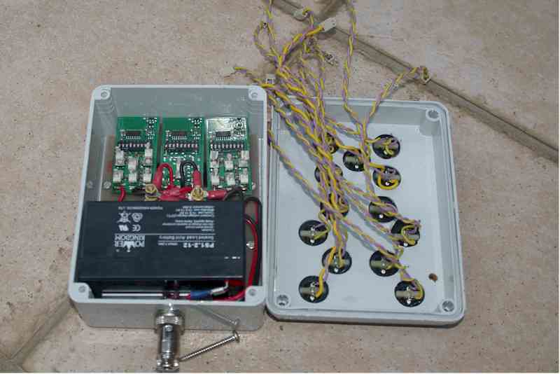

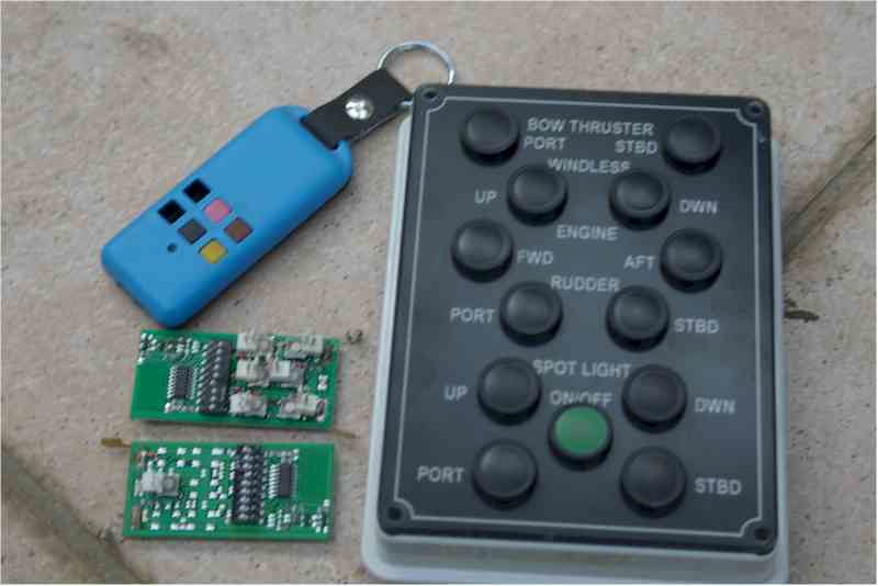

Just checked the log, it was 9 years ago the electric windlass was installed, what a life changer that was! So the foot switches are still in the box, never did get round to fitting them, garage door remote has not put a foot wrong downing and upping countless times. But not a great idea to have something so important without backup switches. Though no way are any holes going to be drilled in the deck!
So tempted to sell the foot switches and just go for a trailing lead through a dorade with some sort of waterproof rocker up down switch. Or make roving box for the foot switches. But that just seems too bulky when a hand switch will do just fine..
Nothing much on ebay for a switch though - any ideas? Must be some sort of microphone looking type thing with a trailing lead and a 2 way switch on top..
We have adopted the same solution. A wireless windlass controller is used with a corded windlass remote as back up.
