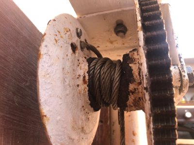

The inner drum on the keel winch on my Jaguar 25 swing keel has rusted and crumbled away. Looking to fix or replace the winch unit, and it needs to be beefy enough to handle the keel - but I have no idea how heavy the keel is - anyone know?
I have searched all the usual places. I did look at Catalina Direct to see what type they supply as a replacement. This looks to me like a Fulton 'braked winch' - you can just make out the word Fulton stamped on the side in the pic. What I can't see is what the actual model is, but if it's the 'K1550' model then that's about £210 for a replacement from a UK stockist. My local engineering workshop reckons they could fix the existing winch, but not for five or six weeks, and that's too long to wait given the time of year.

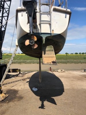

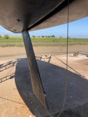

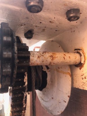

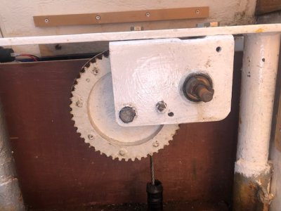

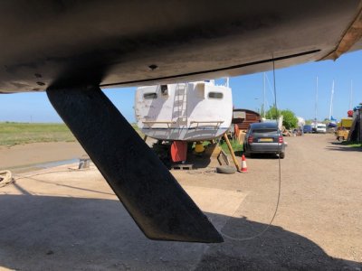

Here’s a couple of pictures of the keel arrangement, and some pics of the old winch with crumbled inner drum (the wire is far to tightly wound round the axel of the winch).
Whilst looking for these I also found a pic of the winch plate before being painted with the model number of the old winch - A Fulton 945 from Milwaukee. Adding here for posterity (and in case it helps some other Jaguar owner in the future).
