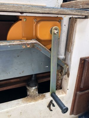

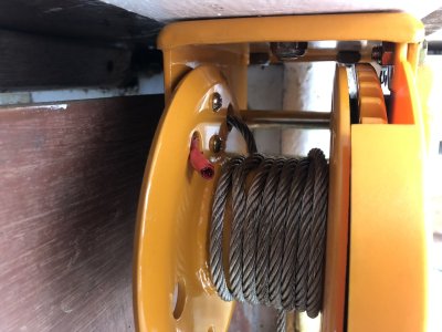

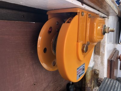

I thought I’d update with the solution in place - tried it out yesterday and pleased to say it all seems to be working.
The last picture shows the new winch handle as supplied - this doesn’t actually work within the available space as there’s a step that needs to be lifted up and so the winch handle needs to have a crank in it. I have adapted the old handle to fit the new winch - it’s a little wobbly but works well enough.
