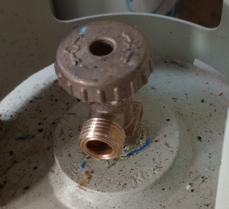

I am having problems in finding an adapter for my Safefill gas bottle. It is a UK POL fitting but I need an adapter which can be filled in Greece and Italy. Some of the bottle filling stations have an adapter and can fill the bottle, but others don't. They say they will if I can can provide an adapter. I can't find the spec of what I want, but it is smaller than the German one (I think that is a KLF fitting). The Greek/Italian one is LH thread and seems to be just over 20mm. Is it a "21.8 LH" fitting?
This is a pic of what the bottle looks like and what I am trying to find:
If I can't find one - there is very little info put up on websites about sizes! - but if I know the spec than I can get an adapter made up.
Not sure I understand your question. Safefill use a standard autogas fitting and what you're showing in the photograph isn't a Safefill bottle, what do you need an adaptor for🤷‍♀️

Ah, the first site says that 21.8 LH fits German bottles. The Greek/Italian is smaller.
However, I've ordered one to see whether it's what I want. It might be possible to get an adapter to go from German to Greek.
