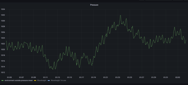

And Openplotter is made for you, raspberry pi will do all the work & send the data wherever you want, and log it all for pretty graphs, barometer is fascinating :)
Never knew there were daily tides in barometric pressure!

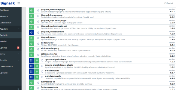

That's not actually how it works. You need to run a program (called a server) which does all the work. Usually on a Pi with a custom operating system - openplotter, comes with most stuff like signalk & openplotter already installed with tools to click on for updates or install more so everything is known to play nice together. Feed any nmea0183 data through a usb/serail or wifi or get a nmea2K usb adaptor to get the data in there.
No need to know anything about Linux, write openplotter to an SD card and turn on, point to the GPS & off you go. On a tablet join the openplotter wifi network and all the nmea and signalk data will be coming in.
It will take data from wifi, pins on the Pi or USB, dozens of plugins to talk to devices which do all the work for you if it's not nmea data.
List here of other systems which can talk signalk, but no need, jyst use nmea like everyone else
Signal K » Applications & Solutions

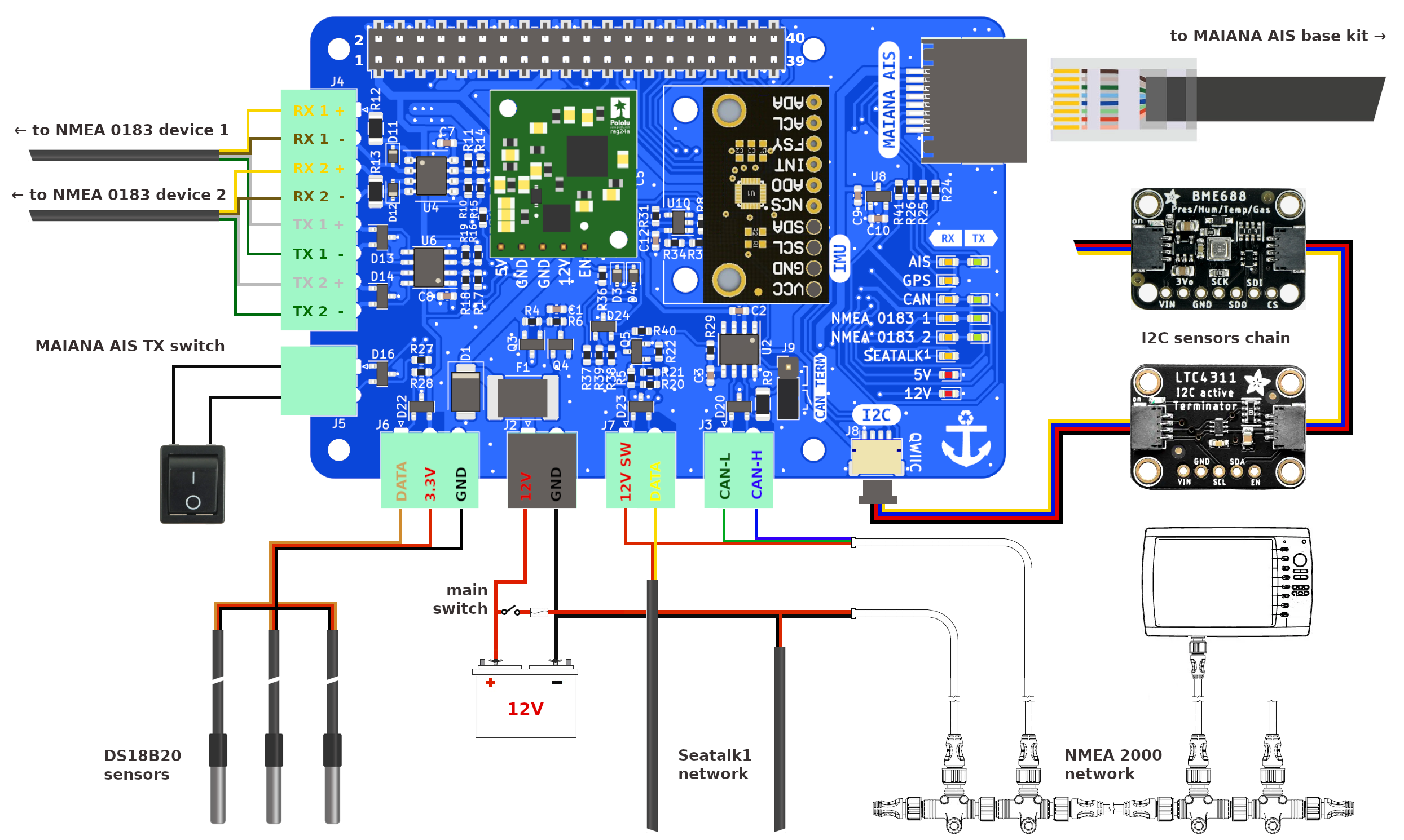

Not that I know of. It's opensource, not commercial. But a plugin board should be available soon, think this guy is a tester. "Necessary software" - click a mouse you can do that.
But again, do you think it was doom & gloom on web forums that gave you the idea that you need to be good at electronics & programming?

I don't claim to be an expert - but your diagram included certainly doesn't give much reassurance that it is yet a mature product for non-hobbyists.
To my mind, as said earlier, it will be a mature technology when I see advertised on Cactus Marine (etc) an affordable box that I can plug in a SeaTalkNG spur cable and have up and running.
And/or Signal K is included in mainstream B&G / Raymarine and other MFDs.
To be honest I am surprised that it has not made as much progress to mainstream as I had hoped when first read about it many moons ago. It needs a breakthrough "plug and play" product.

Interesting, but how is it any different to any other plotter etc?
Terminal blocks for nmea083 & for nmea2k, means wiring n2k in instead of just a plug. All the other terminals are for stuff that no other marine device can do, you can ignore them.Though no point to compare to a chart plotter, have you ever downloaded and installed opencpn onto a laptop & got nmea data going in? More of a realistic comparison. If that sounds a bit much then you could well struggle.
But to reiterate, this thread wasn't started to discuss good/bad opinions but Why any bad opinions came about.
