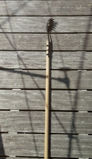

On my previous boat we had 2 weed wands one traditional one like Flaming is suggesting, but we also made up another one which was a plastic spahetti server attached to the end of a stick - which we actually used much more as it was much quicker at getting stringy bits of weed off as you could twizzle it to catch the weed like you would do spaghetti.

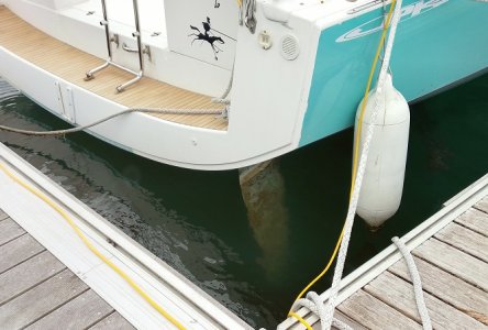

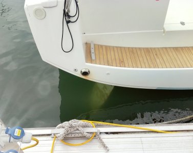

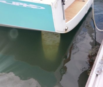

Just curious I took some pictures of a JPK opposite my boat, the rudder leading edge is about 80-100cm from the transom, the shaft about 100cm from the side of the boat, how do you manage to clean these rudder blades while being onboard (supposing no orangutan crew)?
Recently made one following your suggestion, can confirm it works very well :)
