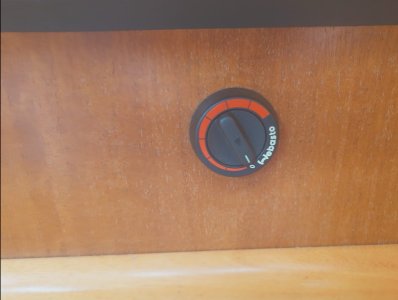

Now we have cooler weather I tgought I'd run my webasto heater
Turn the dial and nothing happens. The dial quick flashes 5 then slow flashes 9.
I've not used the heater for many months, it was working fine in the spring.
Whats the issue, and how do i fix it?

Sorry Graham, but that's not correct, it isn't how the codes are read.
The first, quick flashes, indicate a fault. The second, slow flashes, indicate the fault. The "sub code" you mentioned can only be accessed with a PC and diagnostic software.
In the case of the OP the fault code is 9, a defective glowpin.
A new burner tray and glow pin sounds like it’ll get you warm again. Easy to do yourself, there’s loads of pattern kits on EBay for the smaller heater (2000?) for under £50. I think this is because they’re also the size heater used in trucks.
The 3500/3900 are about £325 for the genuine part.

It was working fine earlier in the year. We had a good summer so not used it for many months.
How can it have developed a glowplug fault sitting there idle?
Are there any other things to try before taking it all apart?
It has a simple dial control with a green light that flashes in the middle

You can try any number of other things, but they won't fix the glowplug ;)
