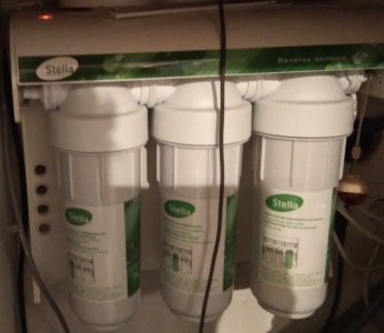

All I can say is from personal experience and other people in the same marina, all the water filters had dirty filters and needed changing often,.
may well be (and probably is!) the pipework/infrastructure is old and misbehaving. Had that here as well, most roads dug, new pipes fitted. Still I have what Clancy Moped has under the sink at home, gives nice clean water for drinking/cooking/tea/coffee.
