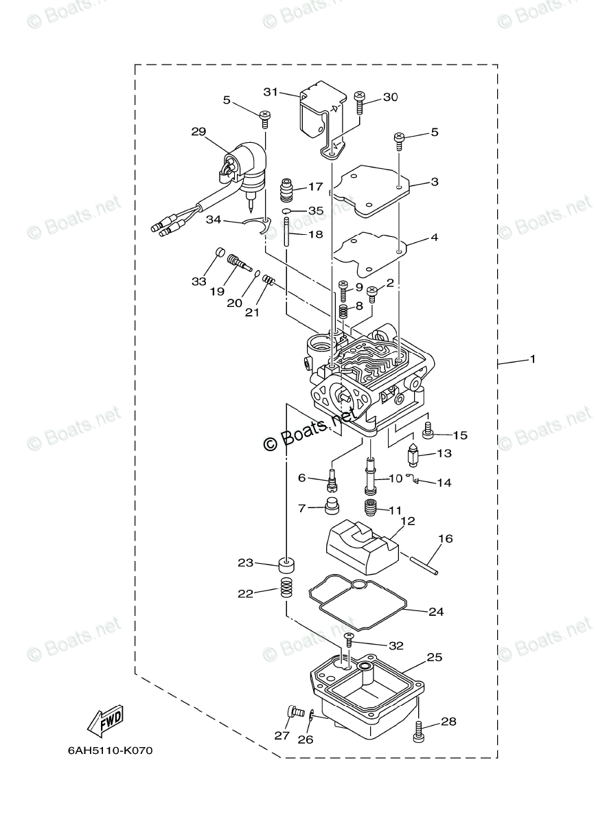

You dont say what year your engine is but the drain is #27 in this diagram

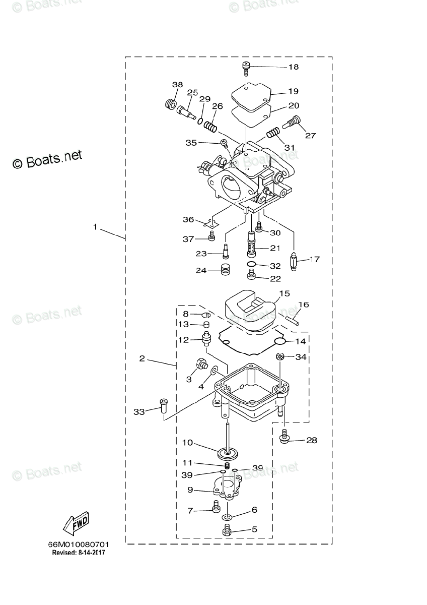

#3 and #5 in this one
hi vicS---i was hoping it would be you that replied---the engine is an f15 2003 ---i have looked in the manual but no mention of a drain plug----will look for the drain plug as per your diagram ----i pumped long and hard to force the petrol out of the carb because the bulb kept on going soft-----still mystified as to where the water came from----anyway many thanks for your reply and diagram
