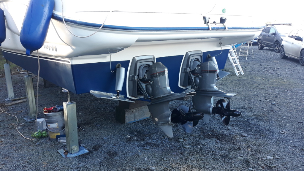

Hard to tell the difference between the DP varieties. This is what they look like if that's any help? They look like AQ290-DP to me?
Looking at the cones on the props, hydraulic trim rams and shape of the top of the outdrive case doesn't that make them DP-C or later ?
I agree the differences are not easy to spot.
These for comparison are DP-E
Hi, These are post the change where the drive no longer had the stainless steel inner hanging frame attached to the trim rams, therefore these drives should be filled with synthetic, API GL-5, 75W-90 gear oil.
These are definitely not 290DP. They are either DPD, DPD1 or DPE drives and should use the 75W90 GL5 fully synthetic oil.
I do, however, think there is something not quite normal with that set up. I have DPD myself and had DPE on my last boat, and neither had the big rubber pad at the top of the transom shield. I am wondering if you have a mix of parts.
