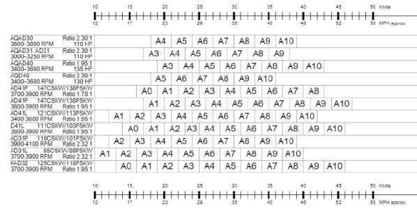

You need to know your ratios as well, you could need anything from a A3 to A7 depending on the ratio and speed range of the boat etc.... see below
The A type has a rubber bushing which is intended to help absorb a shock load if you hit something with the prop.
The J type has no rubber bush.
The J type is a newer design claiming to have some benefits. From what I hear you go up a number so A5 = J6.

@Chris_d , do you have the same diagram for J type of propeller?
Volvo don't sell A or B anymore but J instead, the charts don't show J's. You can buy after market A type, Keypart stock them at a reasonable price, personally I'd stick with A type if you know what the correct size for your boat is.
