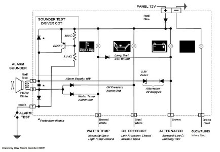

So I recently boat a Dufour 36 Classic with a VP 2030MD.
There is no sound (beep) from the control panel.
I tried the following:
Engine on button
Switch the rocker switch down (Test Alarm)
No sound
How is it supposed to work and does somebody know what to look at?
The error lights (battery, heating, oil) seem to be working, just no sound at all.
