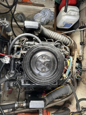

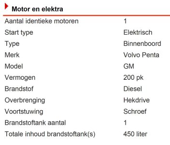

I'm going off to look at a boat next week and the advert says it has a Volvo Penta GM diesel engine of 200pk
It looks like the GM V8 diesel of 6.2 or 6.5 litres but not 100% sure, also what would the likely type of outdrive leg would be fitted to this?
Anyone got a clue as to the model?

Engine in boat:

If it is a GM V8, then it is nothing to do with Volvo. Could be a Samurai which have an undeserved bad reputation for the conversion work. Otherwise, as you know a bullet-proof engine if not overstressed. Without a turbo the 6.5 will put out about 170bhp and less from the 6.2. (These figures from my own investigations so not gospel).

Volvo did badge engineer various engines, and this is one of them. As the Boat is in Holland unlikely to be touched by Samurai.

I don’t think so. Most V8 petrol cruisers don’t have a lot of value in them. Replacing with a like for like engine is much cheaper and easier.
The engine above, I don't know though, the 6.2 V8 was 147 or 149 bhp and the 6.5 V8 was a little more, the 200hp of the above has me stumped, they had to turbo or supercharge them to get them up to that kind of power.
This was part of the specs of the boat a 1987 Bayliner 2850 Command Bridge - well it is almost 10 years newer than the boat I have, I'll see it later this week just I wanted to know a bit more on what it actually is so I could make a better informed look at it.
Just had a thought: It still could be a GM with a VP outdrive
but the 200pk??? (=200ps = 197hp)

I think the idea of replacing the petrol v8 with a diesel one was to try and make it affordable to run, a petrol boat may be cheap but someone on a budget may struggle to feed it petrol. Not saying it does or doesn't make sense, particularly since the petrol outdrive wouldn't be ideal. Worth checking if the diesels were what it left the factory with rather than petrol ones.

Trust me, VP did not badge engineer a GM V8 diesel (yes they did use GM V8 petrol engines). My bet is that it was originally a VP V8 petrol, with a VP drive, and it still has the VP drive but is now equipped with a GM V8 diesel of unknown origin in the engine room. If its cheap enough, and all running correctly, it could still be worth having, but if there are any problems with the way it runs and performs I would run a mile. I would definitley not proceed without a good solid sea trial.

May be my suspicious mind but get a boat with petrol v8s, stick in diesel v8s with same outdrives and have it somewhere it can't be sea trialled to hide the unsuitable outdrives and lack of power.

If it has indeed been re-engined from petrol, this might be a problem in waiting. The original outdrive would have been propped and specced for a higher revving / lower torque petrol engine. The diesel won’t make the revs and will almost certainly have 2x the torque so this might be a marriage made in hell…

I ran a pair GM 6.5 in Samurai blue… in a boat.
Not terrible but noisy and thirsty. Boat ran at 30 knots but took a while to get her in that position. Stanadyne fuel pump was a pain in the rear. From memory…internals wear the housing so it bypasses and give you lack of fuel…something like that.
The marinisation was top draw though by whomever did it. Bowman heat exchangers and oil coolers and custom stainless cooled exhaust manifolds
It was coupled DP-D drives too with the right ratio’s
