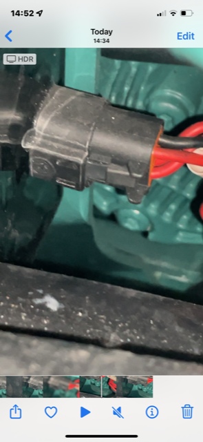

Ok. Eventually got to the DC/Dc box. It’s really difficult to get at 😤
The connection seems fine
I’m presuming a DC/Dc Replacement

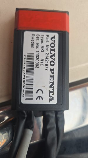

I just changed the DC/DC unit and there is no change. Still no power. When I plug in the old and new one there is a small noise coming from some where in the engine.
Any suggestions please for the next step
