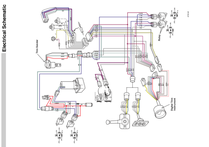

Hi, does anyone have a copy of the Volvo DP-G drive manual, in particular to cover the wiring for the power trim, I can get the DP-C but nothing online with detailed instillation for the DP-G.
I had a drive come full up when under power, either dodgy connection at the back of the boat connections or a relay has failed. Got the drive back down with disconnecting and re-connecting and have left the power disconnected so it wont do that again.
I will do a full clean up and check relays but not sure exactly the wiring, there appears to be three of them on the stern plate next to the pump unit on the starboard drive.
Any help much appreciated, I have Targa 34, KAD300s with DP-G drives.
