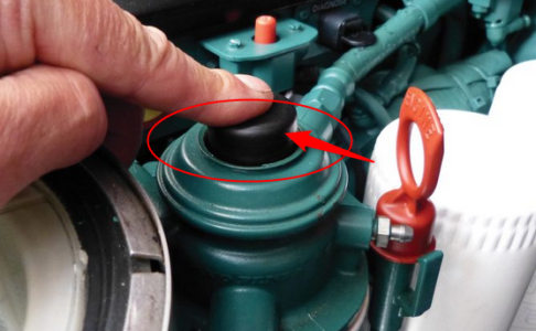

Hi Everyone, so an update - After I replaced all the washers and new Bolts ran engine and it stalled... left it for a few days (as fed up), went back to it yesterday and before priming the fuel filter, I closed the fuel tap and then proceeded to pump the primer, causing a vaccuum, where the primer head stayed down.. i thought, well if theres an air leak it should start to rise up eventually... it moved a little and I ended up fiddling with the black primer button and twisting freely around... since then..not one stall, Ive had the engine running and off for 5 hours, left over night, stop started at least 20 times, left for an hour, restarted again and again.....no stall.. do these fuel primers/buttons tend to have an issue ? would spinning the black button really do anything differently? or have i delayed the inevitable...? its one of those...is it cured or simply hiding waiting to re emerge...1694602904244.png

Couldn’t be 100% but, I’ve just had a similar issue, replaced the unit and all my problems sorted. There again finally got to the stage where the primer pump failed to go ”hard” so a lot clearer in terms of where to look!

Thanks, Yes, Ive ordered a replacement to fit next few days..even if its not this, at least narrowing it down :-)
Update for everyone and Anyone - Ordered and installed a new Fuel Pump primer housing (came with new filter and sensors)
Ran engine for around a total of 6 hours working up to operating temps, in gear etc..Given boat a full blast since,, WOT 28 knots , pootling around at 1000rom . Mooring up, restarting etc.. No issues.. So hopefully this was the problem..as like most things now, the slightest engine noise and Im carfeully listenning hoping nothing is goping to stop.,.....
