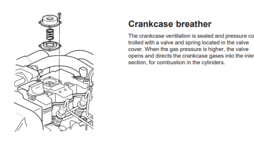

There is a pressure controlled crankcase breather system.

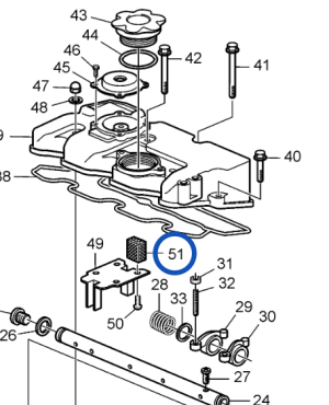

From the workshop manual:
The parts list show a filter, #51, in the system inside the top cover but I see no mention of inspecting, cleaning or replacing this as a routine service task. Something to look at perhaps when the cover is removed to check the valve clearances on a 500hour / 2year service
