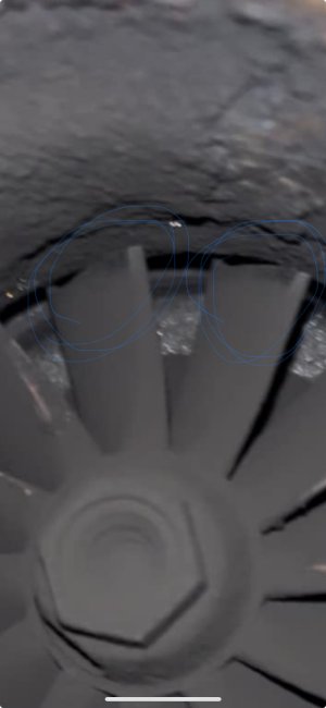

Jumping on this as it’s the closest I can find to ask this question but I’ve never need a turbo with burnt tips could someone shine some light on if this gap is to big, I recon yes but would like a second opinion.
Volvo KAD 300
Floating at 2100 and not getting off of the super chargers
Volvo KAD 300
I would say that turbo is knackered. Gap looks pretty big. New ones have a tiny tiny gap.
Yeah this was my thoughts also, I will try a boost gauge on the engine but will be hard to get a reading as I can’t get it off of the super charger.
But this being said I think the gap from factory is 0.4mm between housing and vains so I recon it’s safe to say it’s needing changed
