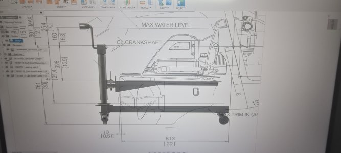

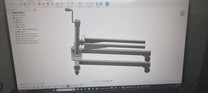

I'm going to order the volvo stuff shortly, I'm making an outdrive trolly just now first. Knocked up in CAD and ordered metal today.20240204_214812.jpg20240204_215433.jpg
