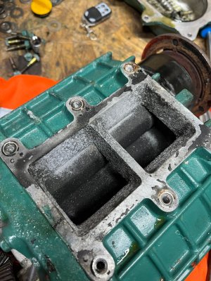

Just a quick update, confirmed today that the supercharger is indeed seized again. Engineer has removed and I’m hopeful it can be freed up and doesn’t require replacement.
Will catch up with the engineer tomorrow to see what further investigation can be made, as my post above indicates the exhaust elbows have been replaced recently, if anyone has any other thoughts on what could be causing or contributing to the issue I would be very grateful.

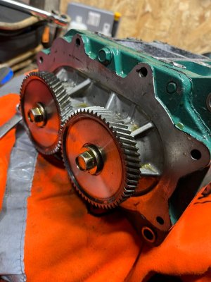

@volvopaul photos attached.
Engineer confident again that it seems to be water ingestion over fine related. He is hopefully going to get the supercharger freed up.
Any thoughts on potential sources of water, from my limited understanding it can only be entering via the air intake? Could there be a source leaking near the air intake when the engine is under load?
Once the supercharger is freed, it will be reassembled and further testing carried out.
Any thoughts welcomed!
Thanks again

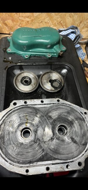

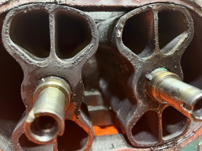

Certainly looks like carbon / soot
All evidence is now pointing to that being the case, more photos from today and certainly carbon / soot build up.
Pleased to say supercharger is looking ok for strip, clean and rebuild. Once reassembled we will sea trial extensively to confirm we no longer have any exhaust leaks or other issues.
Appreciate input from people so far 👍

As VP said. This is a unit that cannot be reconditioned except for front bearings and clutch. TBH yours looks very worn to me and I would add to the pot here, have you been over revving it? They are good to 11k rpm indefinitely but with belt reduction that is easily over achieved if it sticks on. Then indefinitely very quickly becomes definitely FUBAR. Check if its losing oil out of its reservoir. Thats a dead give away too

Look at where the air intake is into the air filter box . Its just there next to the exhaust . So and exhaust leak would sucked straight into the air filter box
What condition was the air filter in? Usually after a year they come out looking okay in my case and certainly not black all over.
Was the air filter wet ?
