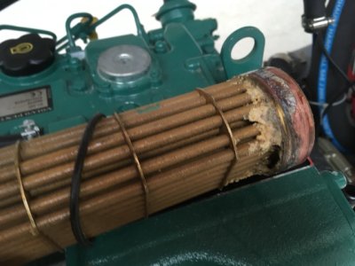

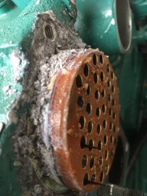

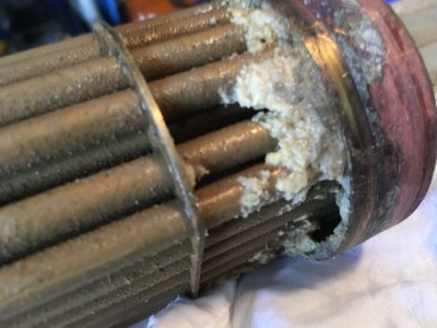

I have a 2014 D1-30F with just over 3700hrs on it. I have removed the matrix twice in that time. On the first removal there was a bit of crap on the outside of the tubes that would not have been visible without removal. I believe that this was a result of a bit of sea water seeping past the o-rings on the discharge side as there was corrosion in the aluminum casting in that location. Yours may be fine but if I went through the trouble of pulling the end caps off I would pop the core out. Just my thoughts.

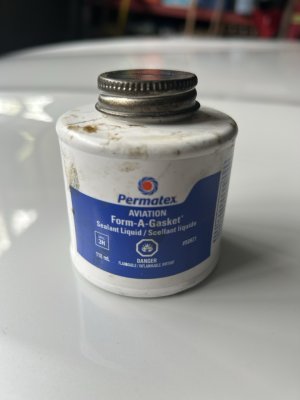

Just updating my post with a couple of photos that I found that shows condition of the tube bundle and discharge end of heat exchanger. After cleaning it up there was a fair bit of corrosion on the aluminum casting but fortunately I was able to repair it. This was from the first time I removed it. The second time it was fine. NOTE: When I repaired and reinstalled the matrix on the first occasion, a Volvo Mechanic recommended that I coat the two o-ring with aviation sealant to help address seepage past them. I've had no issues since. Apparently it's not uncommon for seepage past the o-rings which in some cases result in severe corrosion.
