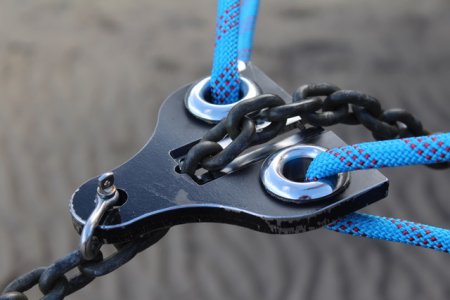

The advantage of these processes is that the galvanised coating, a number of layers of FeZn alloy, can be specified for thickness, the gal coating can be thicker, like double, that of HDG and the coating is harder than HDG. The coating in use, at least in the rode, self polishes on the seabeds to look like black stainless - and does not hold mud, so is easier to clean.
Our 6mm HT chain, replacing 8mm chain, after 7 years of service.
