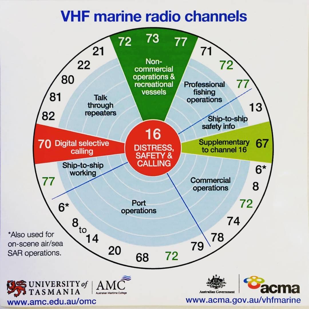

Something like this pinned up by the VHF might be useful
A UK rather than Australian version, perhaps. More of that wheel is wrong than right, here.

I did say "something like". The clock face representation struck me as a good idea.
Yes, I like the idea.
Yes - I just wouldn't want less experienced people to take it at face value and think - for example - that 73 is a "recreational vessel" chat channel when it's actually a Coastguard working one. Or that they might be able to call their mates on 67 as "supplementary to 16". Or use "talk through repeaters" that don't exist on any channel.
Personally I find the way that layout has several copies of 72 and 77 confusing, and including - in fact emphasising - 70 is completely pointless.
Tastes vary - I found it thoroughly confusing, with its repetition of numbers in different parts of the clock face.! The table on the RNLI site is much clearer to me; that (with irrelevant channels removed) would be much more useful as an aide-memoire for me.
