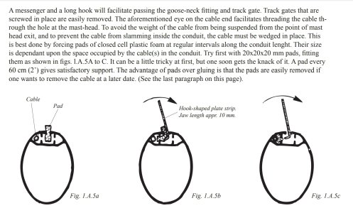

Others will come along later with specifics for a Contessa 28 mast, although yours might not be the original..
However, as Boathook mentions, there are some Selden mast sections that take cables tucked away either side of the track..
Extract here..
And the full Running Cables document by Selden below (for mast sections pre approx. 2003)
https://support.seldenmast.com/files/1453127773/595-557-E.pdf
