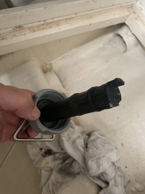

Pic of my old damaged sum log, found a new one online a few years ago, think it was around £250 😱
Yes that the later paddle wheel version ... mines the mechanical cable driven older type.
TBH - I was surprised to see it on the boat - but I suppose in 70's it was pretty well THE standard ... it was seen a lot on sailboats ..
