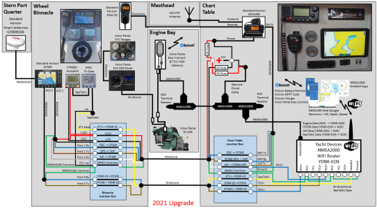

I have setup a Raspberry pi with open plotter and can connect wirlessly to my Tablet and Laptop. I can receive AIS and GPS and can read my instrument Data Via Seatalk, I would like a multiplexer but cant afford one. At the moment I cant use my Autohelm whilst connected to the seatalk bus :unsure:
I had a similar problem and it was due to the Seatalk1 bus being overloaded with data routed from other busses by the WiFi router - the Autopilot just wouldn't hold a course. Removing all routing of data to Seatalk1 in the routing table of the YDNR-02N solved the problem.
My system looked like this ...
