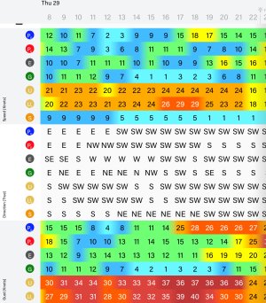

But which forecast? I always look at multiple.
For the next big corner, the forecast for Thursday has GFS (XCWeather) showing Easterly 3kts gusting 5kts, whereas UKMO is showing SW 22 gusting 27kts. If just looked at one could get badly caught out. But comparing GFS, UKHO, ECWF and Spire on Predict winds tells me to not trust the GFS optimism. Will see how resolves tomorrow.

Compare the last three lines, of this Predict Wind summary of forecasts for just 36 hours out … so punk, do you feel lucky!IMG_1721.jpeg
Compare the last three lines, of this Predict Wind summary of forecasts for just 36 hours out … so punk, do you feel lucky!View attachment 193936
