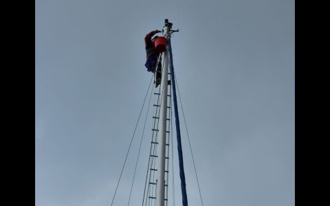

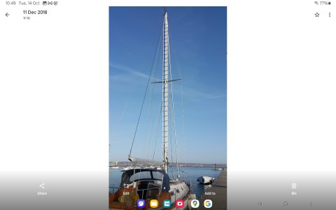

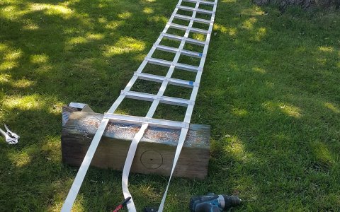

I bought a reel of webbing and a few 6m long aluminium right angle to make the steps. Every step has a sail slider so it goes in the mast track and you can get tension on it so its not floppy. My topping lift is then ran from mast top to mast base and tensioned and i run a troll rocker which slides itself up or down the topping lift as a safety line. I use a bosuns chair with belt/buckle so it stays around my waist and doesn't slip down when climbing plus it has storage compartments and is comfortable to sit in when at height.
It works so well that others keep wanting to borrowing it..
The whole lot fits in a lidls bag.
