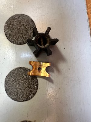

Thanks for the replies. The cam plate was the only bit that I didn’t replace when I rebuilt the pump in June. It was a part I looked for but couldn’t decide what was the right part to order, I’ll have another look. Whilst I fitted a new impeller at the time, it’s of course possible that something has happened to the vanes. I will take a look.

Update, I replaced the cam and the impeller and whilst I haven’t yet been able to motor off, I can visibly see better water flow out the exhaust.
The old cam was 2.3~ mm thick and the new one 2.6, I also saw that the two month old impeller was deformed more than expected. I know they get like that but haven’t seen this with such a new one. Replaced it anyhow.
