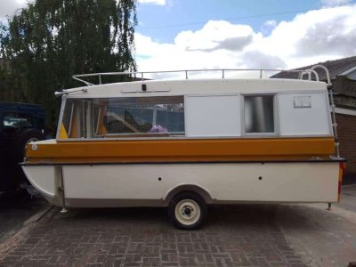

Hello newbee here.
I'm in the design stage of converting my classic caraboat to electric propellsion on a budget.
The question is I'm thinking of fitting 2 Bison 24v 100lb trust trolling motors rather than a 120lb single unit but where should I fit them? Normally with twin props they turn oppersite to each other (one anticlockwise and one clockwise) but with these electric motors they only turn one way. Will this course a problem?
Also I'm concidering to fit them either side of the door so about 4 ft apart. Again is this wise?
The caraboat has a cathedral hull.
Thank guys

If it originally had a waterjet propulsion system maybe a Warrenjet outboard would be more appropriate (and bonkers). I sold one recently that I had used once much to the amusement of onlookers. I think it went for £40.

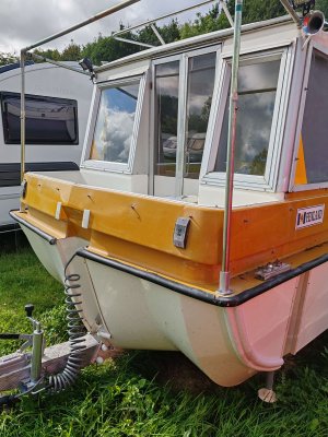

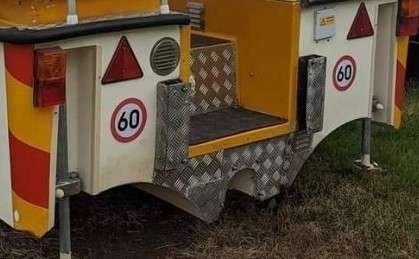

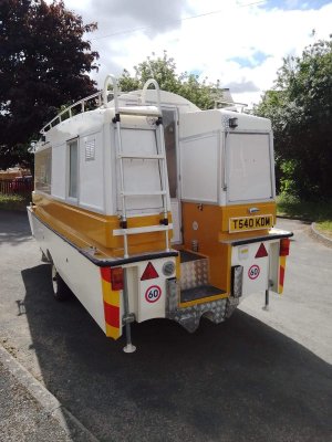

Hello newbee here.
Thank guys
A question on hull displacement.
I attach a photo of the hull. I'm assuming a single motor would be most effective due to the tunnel where the waterjet would have exited. Can anybody suggest the effect the hull would have on twin motors positioned near the 60mph stickers?
I guess I'm looking at torque rather than top speed possible as I'm aiming at around 3 to 4 mph max.
I'm still bouncing from single and twin motors

I am not sure even 2 motors of that power will give you much speed or particularly control. It is not clear where the waterline is, but the location you propose is at least in clear water. You will need a substantial bracket for mounting each motor and connecting them so that you can use them for steering. I assume the water jet was directional controlled by the steering wheel. Controlling and steering the outboards from the original wheel will be quite a challenge.
Wlid blue yonder
12 Jan 2024
12
They sit high in the water and the bottom set is exposed. The original jet water wasn't very effective and the story goes it was the downfall of the caraboat in production. Designed for canals system. I'm basing my design on a caracruiser that's slightly smaller and lighter as it doesn't have a built in trailer. I know of one of these running with a Bison 24v 100lb brushed motor so I'm fairly confident the Bison m250 would push it along in the right conditions.
