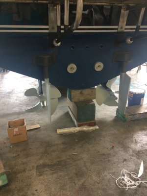

I use them on my bathing platforms SS structure .Doubled up and even connected the internal bolt heads ( that pass inside through the transom) to the gen boat bonding via those two round transom anodes .
Zinc is cheap . ——- well in the bigger scheme of boat maintenance and running costs .
Having said that the anodes on the SS degrade very slowly last 3 yrs .The main anodes are changed annually by comparison.
With your Bennett’s you do not really know the bolt material , If a yard bozo fitting has drilled the SS thus compromising it a little or as mentioned what other metals are in direct contact.
Its your roll of the dice disregarding fitting anodes .
Might look bad on a future survey …….in terms of what other cheap outs have been practiced entering the buyers head .

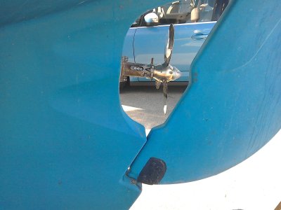

Just to demonstrate. in the photo the fitting at the bottom of the ruder (dark blue because it has just had an extra coat of AF) is 316 stainless attached with 316 bolts. It has been there since 1979 and is in perfect condition. 316 underwater does not need anodes. However if it is connected to other metal such as aluminium a galvanic circuit will exist and the aluminium will corrode (not the stainless). An anode wastes in preference to the aluminium. Sterndrives and saildrives are examples where this works.
