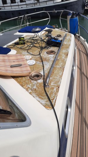

Golly. We’ve replaced all of ours. I wish it was a bit kinder on the knees and i sometimes wonder whether I should have explored the options of the fake teak s bit more but overall we’re happy with the durable and very none slip qualities. IMG_3409.jpeg
We’ve got acres of it.

Me too. Not on the same scale as yours. Just the area on the coachroof where the reefing lines etc and winches. Now replaced with 5.5mm wide 1.5mm thick teak strips bedded on CT1 and caulked with sika 290. finished today. Like the Treadmaster on the deck and particularly the heavily cambered coachroof so won't be removing that even if it is ugly. Will however do the cockpit in the same way next winter.
The teak strips are structural veneers which I cut to size with my bandsaw. Enough to do this bit of coachroof, the cockpit and a hatch garage (when it gets made!) under £200.
