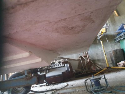

Can someone kindly tell me what height my outboard motor cavitation plate should be in relation to the stern of this boat ? It’s a 15ft long planing hull , I’m just not sure if it should be slightly below the V in the hull or in between the flat hull and the V. Any input very welcome thanks. Stan.
That's a very difficult question because that hull shape is so unusual. Anyone answering is guessing, including me.
Trial/error is the only way to find out.
I would say never below the V. Always between the flat and the bottom of the V, but exactly where depends on speed.
If boat is slow (say 40hp or less engine) then I would put the cav plate 2 inches below the flat of the hull.
If the boat is fast (say 70hp upwards) then I would put the cav plate 1 inch above the deepest part of that V.
Hopefully you can adjust it and therefore apply trial/error. Good luck!
Thank you Jfm, that’s exactly the way I am thinking, I’ve never come across a step like this at the stern it’s almost as if someone had added on length at the stern but that doesn’t show on the hull ! Engine wise I’m going to fit a 50hp.

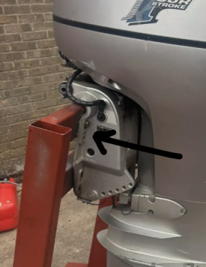

Are there not any previous mounting holes ?
