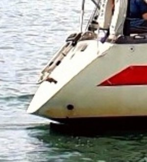

My sailing boat has an angled transom and the ladder does not get anywhere near the water, even with lowest step folded down.
It makes getting aboard after a swim difficult for the fit, and impossible for some.
I've consideted getting a longer fold down ladder, but I suspect the angle will just put too much pressure on hinges/fixings. Or will just not reach into the water far enough.
Am I missing any simple solutions? Screenshot_20230415_075355_com.android.gallery3d_edit_935023471779717.jpg

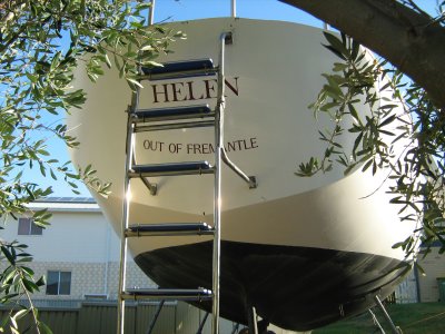

I got a guy in the trade who charged me $A10 for each bend and each bend was exactly the same. My Son did the welding and I got the steps out of a recycle bin at a plastic sign fabricator.
I had my back up against the fence so I couldn't get the bottom rung in. I've got two steps in below the waterline and the experts tell me that is a bare minimum.
I will have a rope from the top of the (folded ) ladder to release the bottom so it swings down into the water.

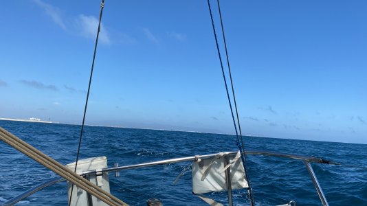

why the urge to climb up the transom? A standard ladder by the shrouds would be simple. and much more aesthetically pleasing. I really don't like the look of boats with a ton of scaffold off the stern. If you want to get on and off at the back build a sugar scoop or a fold down platform.

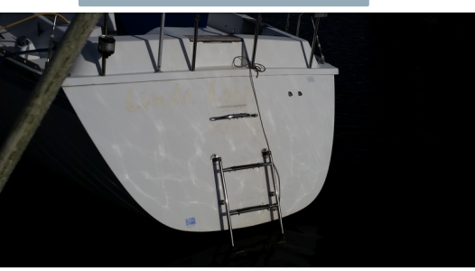

I guess post #8 refers to something like this.
Forgus 31 - Segelbåtar - Segelbåtar - Båtguiden - Maringuiden
(click the photo for a closer look)
The hinges are here positioned about halfways between deck level and transom bottom.
One disadvantage of the ladder pictured is that there will only be one rung below water level, but there can be made an extension at the end, either fold down with another hinge or telescopic.
