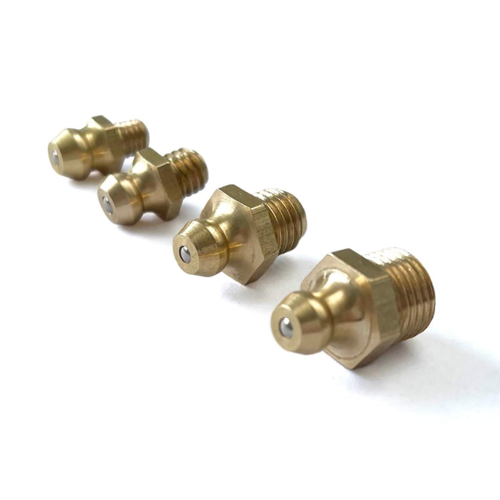

Thanks Kevin, not sure on weight but its a twin axle heavy bugger, so you could be right on that. I was trying to push it in just with body weight, so for an almost 2 ton laden trailer I guess it ought not to move with just my knees pushing it!! There are two grease nipples actually so will invest in a grease gun - are they a universal size? I've never had to grease nipples before (well, I did once, but that's a different story.....!) I didn't realise they were for grease actually, I thought they were just little nuts to release something underneath!

The slide on grease nipple require a different head on the grease gun
