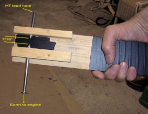

Check the strength of the spark with a spark tester. You should get a good strong blue spark which will jump at least 1 cm. Just checking across the spark plug is not good enough. Improvise some sort of tester if necessary.
Also worth while checking the compression ....... especially if you can find out what it should be !
I think this may be Lakesailor's homemade spark tester
