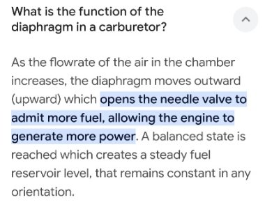

I don't know your specific carb, but many have a small (rubber?) diaphragm which can be faulty. Close inspection needed if fitted as they crack and leak.
Thanks. Is the diaphragm an elementary fuel pump? If so this doesn't have one. Gravity feeds the fuel straight in.
In fact, it can't have one, I've have the carb apart and there isn't one. On my Mercury 5hp it's a very obvious rectangle on the outside of the carb.
