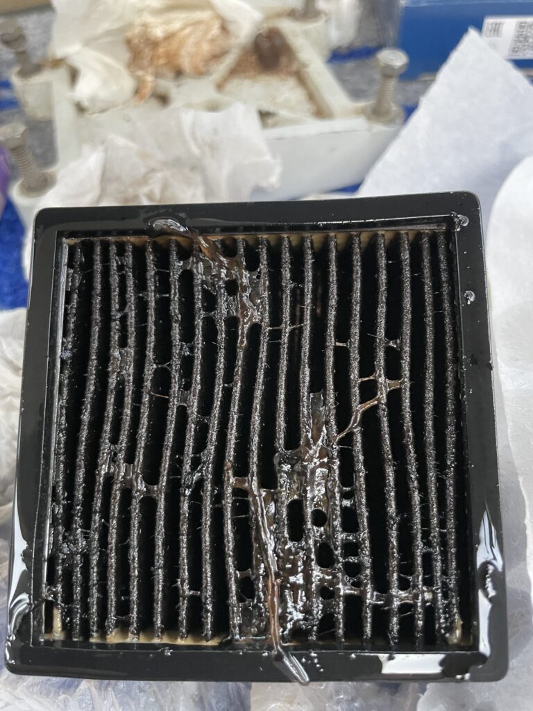

Thank you for this valuable information. Our situation; we have a Sunseeker Portofino 400. It has 990L tankage with largely inaccessible tanks , no cleaning points and removing them is an engine out job. There is no tank drain as such, although there is a pump out point which is effectively a dip tube that is positioned 10mm from the bottom of the tank.
The previous owner had bug issues in the past and had had the fuel polished. We brought our new to us boat home with a full tank of diesel in May last year. On navigating around the coast, we filled the tanks to the brim at our home port where it had about a third left in it on arrival. By late August we were still on this tank albeit about 1/2 full when we had our first problem. One engine (stbd) dropped rpm. It literally hit a ceiling that it wouldn't rev beyond 1600rpm. I throttled back and re-applied, after doing this a couple of times the issue went as quickly as it came. A week later, the same again, I throttled down and reapplied it went again, no black smoke either time. A week later we went out, no issues this time. The very next day, we went out again, this time as we banked left turning into the port it came back, same engine 1200rpm ceiling this time. (again no black smoke). The tanks were now reading a third full.
Following this experience I changed the fuel filters. Both bowls have always looked fine, no water ever in them. The filters were covered in bug. Arguably the Port engine filter was worse than starboard though we never had this rpm issue with that engine. We changed primaries and secondaries on both engines.
I began to suspect that bug or film was blocking the feed line to the starboard engine, perhaps clinging to the gauze or mesh that would be on the end of the feed tube. The intermittent nature of the problem made me feel it wasn't a mechanical problem with the injection units/fuel pump. Our engines are mechanical injectors. I spoke with Marship about their Diesel Dipper which I had previously read up on. By then I had dosed the tank with Fuelset, something the previous owner used and there was a bottle of it on board. They didn't recommend Fuelset because it effectively absorbs the water up into the fuel, which is the opposite of what you are trying to achieve with the dipper.
Thinking the low fuel level didn't help we also topped the tanks up to 1/2 tank. Next time out, banked left and same again, 1200rpm.
So back on the phone to Marship, long story short, the bug requires water to breed, eradicate the water eradicate the bug. I purchased their Diesel Dipper and Marine 16 diesel bug treatment and diesel injector cleaner. The DBT to kill the bug, the DIC to afford lubricity for the injectors, especially as water would have been absorbed into the diesel by the Fuelset and modern diesel being low sulphur removes much of the lubricity out of the diesel which can't be good for the injectors. We added this lot to the tank and I am in the process finally of finishing the dipper install so it will be interesting to see what happens next. I'm of the opinion that Fuelset type additive is not good, how much water can be absorbed into the diesel before it becomes saturated, not to mention it won't do the injectors any good?
While installing the dipper, I was vacuuming around the pump out point on the tank and sucked a load of diesel up, only it was clear like water. I turned the hoover off and the fuel than came out was a pale pink. Bottle on the right is vacuumed 10mm from the bottom of our tank. (The new dipper installation will go all the way to the bottom). The bottle on the left is from the Separ primary filter bowls.
Clearly we have some water or heavily saturated diesel in the bottom of the tank. I'll post more when the dipper is up and running, having spent a fair amount of money and time on the purchase and installation/research etc I'm looking forward to seeing the outcome.
